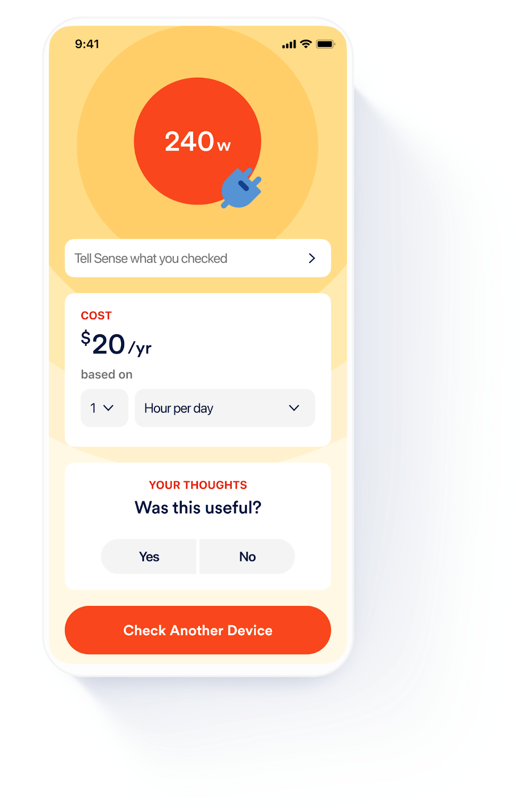

Watt Check will return a results screen that includes wattage used and estimated costs. For the best cost estimate, be sure to adapt the default usage setting to better estimate how much time your household uses the device.
Once you have a result, you can choose to check another device, or return to the dashboard.
If you receive an error, you can choose to check the same device, or a different device, or return to the dashboard. If you do receive an error, you may want to wait till the household is “quieter” electrically, such as later in the evening, then try again.
