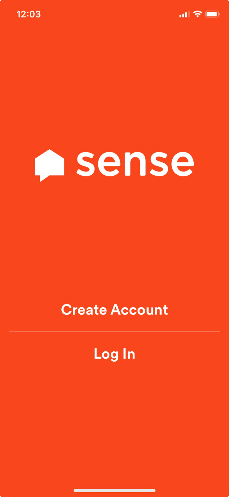

- If your new home has an eligible Sense-enabled smart meter, simply reset your old data, then open the Sense Home app and select Create Account to set up your new system. 📍You can learn whether your utility company offers Sense for your home in this article.
- Be sure to do this from your new home with your active Wi-Fi connection.
